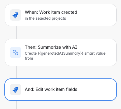

If it's only about work item creation, then you can simply use Confluence Automation for this. 😁
Confluence has a trigger for when a Work Item has been created, unfortunately not for edits. But you could build an automation like this:
Not exactly what you're looking for, but maybe close enough?

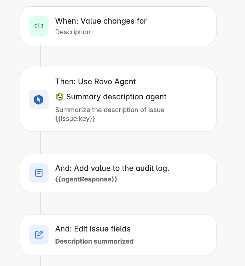

If you also use Rovo, you can alternatively use a Rovo agent to summarize it, I just didn't have a test environment to try it out.
You could create a Rovo agent with the instructions to:
"summarise the description field of the current issue and return the summary".
Then you call that agent in an automation rule and use the result in an Edit issue action. {{agentResponse}} smart value will include the result from the Rovo agent.
