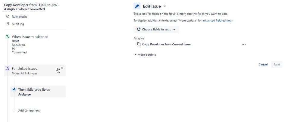

so I thought it was working, but I think you jinxed me as I changed the status, and the Assignee on the JIRA ticket never copied from the linked issue
I put branching in place and here's what I have and it still isn't copying - URG!!
TRIGGERING ISSUE - SFSUPP
LINKED ISSUE - ITSCR
When I have this automation it updates the LINKED ISSUE (ITSCR - where Developer is) to UNASSIGNED - I want it to work the other way around (take Developer from ITSCR and copy it to Triggering issue - SFSUPP)
To use the Lookup Issues smart value, you first need to use the action for it. Something like:
here is what I ended up doing and works perfectly for ONE ISSUE linked to ANOTHER ISSUE
