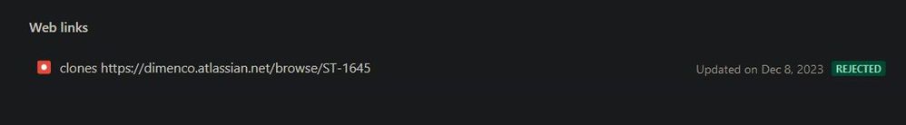

Nicholas Cooprider February 28, 2024
Screenshot below.
It's a company managed project.

Kristian Walker _Adaptavist_
March 8, 2024
Hi Nicholas,
It looks like this field is provided by an external plugin, so I dont believe scriptrunner will be able to access it as its not a standard Jira field.
