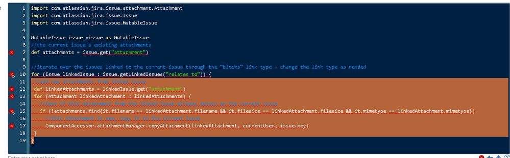

I am getting error :
//iterate over the issues linked to the current issue through the "blocks" link type - change the link type as needed
for (Issue linkedIssue : issue.getLinkedIssues("relates to")) {
//add new attachments from linked issue
def linkedAttachments = linkedIssue.get("attachment")
for (Attachment linkedAttachment : linkedAttachments) {
//test if this attachment from the linked issue already exists on the current issue
if (!attachments.find{it.filename == linkedAttachment.filename && it.filesize == linkedAttachment.filesize && it.mimetype == linkedAttachment.mimetype})
//this attachment is new, copy it to the current issue
ComponentAccessor.attachmentManager.copyAttachment(linkedAttachment, currentUser, issue.key)

Can you please let me know the error. what you are getting

Capture.PNG Please see screenshot.

can you please  include below at the top and try again
import com.atlassian.jira.issue.Issue
