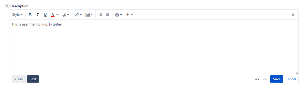

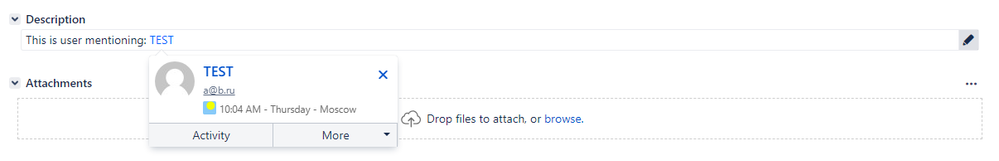

Evgenii
June 22, 2023
to mention user you have to use username, but when you'll look at issue, you will see display name.
For example, difference between editor mode and after editing, when you look at description:

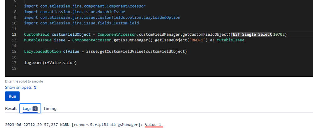

Evgenii
June 22, 2023
Don't know, what exactly you're using for testing, made +/- universal script, maybe it can help you to understand where is problem. It must print selected value from custom field in issue. I tested it in scriptrunner.

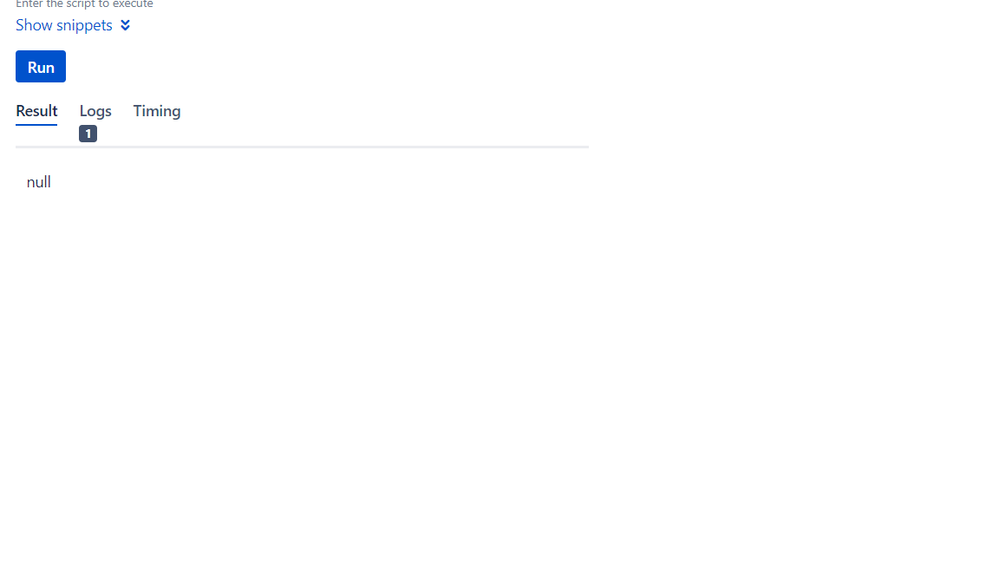

Harsh
June 22, 2023
Tried this on console, but it still returns null. The single select field has Test-1 value
Evgenii
June 22, 2023
Press Logs :)
log.warn outputs messages to Logs tab.
Can you make a screenshot of console screen with code?
Harsh
June 22, 2023
oh shoot my bad.
yes, it is showing. But dont know in post function it is not working.
