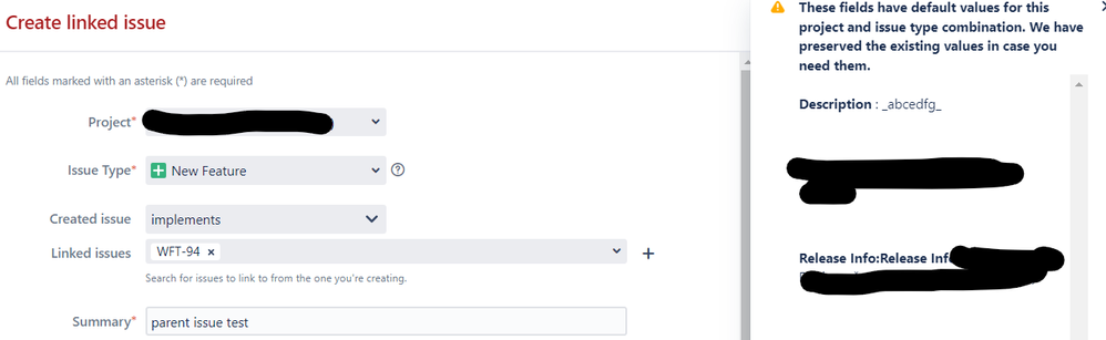

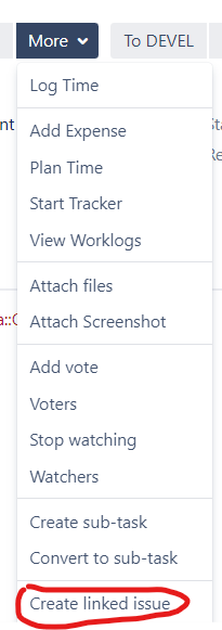

Hello @Ram Kumar Aravindakshan _Adaptavist_ , thank you for answering. I'm not sure whether it's a transition screen, but I can create a linked issue on my issue page this way:
f
which then brings this Create Linked Issue Screen popup
It even has the popup on the right which has the existing description saved so I'm wondering if it's possible to just copy the existing values right away and not have it done manually.

I did some more digging and trying and came up with this workaround
You could setup a scriptrunner fragment to lay in a command into your menu system, put a script behind that to auto create the linked issue based the existing issues values.
Hi, thanks for the answer. This seems plausible maybe the question would then be about choosing the linked issue type (?) meaning that it either implements/is implemented by the parent issue etc.
The idea to have it change in the screen was that the person creating the linked issue could skim over the copied data and possibly change it, but yes this seems like an acceptable alternative.
