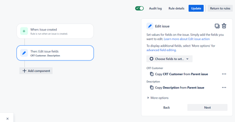

Here is the rule:
While the "Description" is copied from the parent to the new issue as expected, the custom field which is selected list (multichoices) is not.
Any idea ? is it a problem with the custom field type ?
Hi @Gal Fatal
The Issue Created trigger can fire so quickly that some of the issue data may not be available to the rule when it starts. The symptom of this is other rule components do not work as expected...for example: perhaps the parent field is empty.
The work-around to check if this is causing the symptom is to always add the Re-fetch Issue action immediately after the Issue Created trigger. This will slow down the rule, reloading the data before proceeding. Perhaps try adding that and retest.
Bill

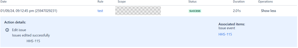

Hi @Gal Fatal
What does the audit log say? did you check?

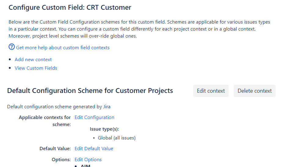

I would also check if the custom field has a context that may not display for the child issue.
Fabian
Hi @Fabian Lim
Thanks.
Nothing special or limitation in the field context. and here is the log.
(I amnaully succeed to update this field on the child)
Field context
