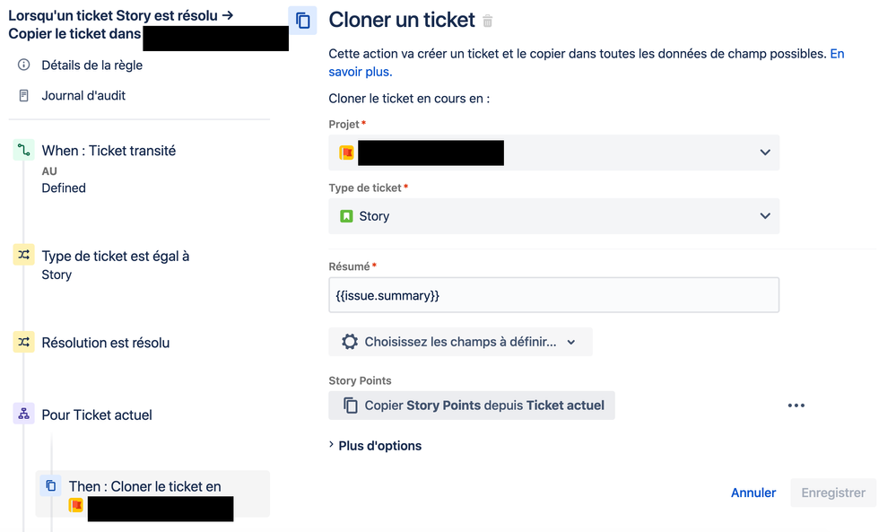

We wanted to have 2 boards (1 for refinement, 1 for sprints), but the new Jira Software does not allow that. So we created a new project for our refinement board.
What we do is that when an issue is moved in "done" in the refinement board, it is cloned in the sprint project backlog.

The problem we face is that 2 information are not cloned with the issue:
Did anyone face a similar problem or does someone have some kind of solution to this problem?
What we tried
We already tried to get the story points custom field id and add it to the cloning action options, but we did not manage to make it work.
