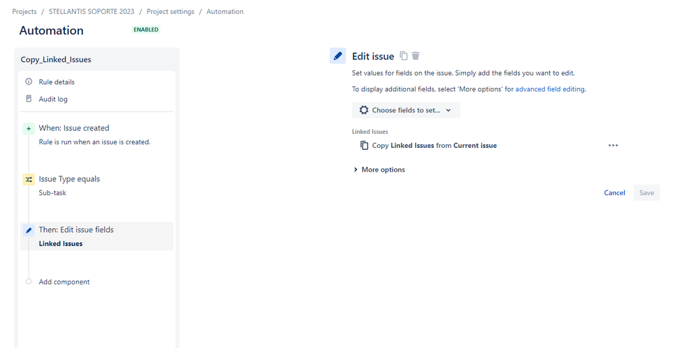

Strange, I don't have an explanation right away. Would you like to add a screenshot of the rule here?

Jose Antonio Quesada June 27, 2023
Hi @Marco Brundel
Here it is:
Captura de pantalla 2023-06-26 125835.pngCaptura de pantalla 2023-06-26 145915.png

Marco Brundel
June 27, 2023
Hi @Jose Antonio Quesada ,
I see you use 'copy linked issues from current issue'. If you change this to 'copy linked issues from parent issue' does it work?
regards, Marco
Like Jose Antonio Quesada likes this
Jose Antonio Quesada June 28, 2023
Yes!!! It works!!!!
Thank you very much @Marco Brundel
