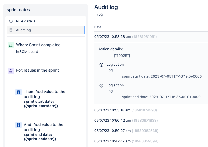

You could create an Automation Rule that uses the Sprint Completed trigger. After triggering the rule you can use the Branch action to retrieve the issues in that sprint. In the Branch you can then use an Edit action to edit each issue in the sprint and fill in the date/time fields with the smart values {{sprint.startdate}} and {{sprint.enddate}}. I used the Log action to print the values rather than actually editing an issue.
If you are using Date Only fields (not date/time) you are going to need to format the above smart values so that only the date portion will be assigned to your fields. For more information on formatting date/time fields refer to this:
https://support.atlassian.com/cloud-automation/docs/jira-smart-values-date-and-time/
