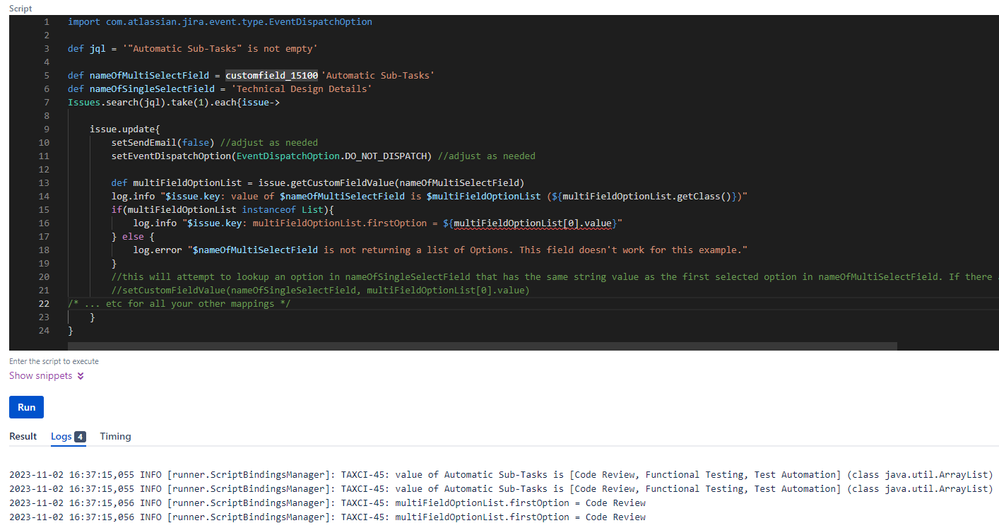

Here is an expanded example that I was able to test in my environment (except I left out the setCustomValuePart):
import com.atlassian.jira.event.type.EventDispatchOption
def jql = '"Automatic Sub-Tasks" is not empty'
def nameOfMultiSelectField = 'Automatic Sub-Tasks'
def nameOfSingleSelectField = 'Technical Design Details'
Issues.search(jql).take(1).each{issue->
issue.update{
setSendEmail(false) //adjust as needed
setEventDispatchOption(EventDispatchOption.DO_NOT_DISPATCH) //adjust as needed
def multiFieldOptionList = issue.getCustomFieldValue(nameOfMultiSelectField)
log.info "$issue.key: value of $nameOfMultiSelectField is $multiFieldOptionList (${multiFieldOptionList.getClass()})"
if(multiFieldOptionList instanceof List){
log.info "$issue.key: multiFieldOptionList.firstOption = ${multiFieldOptionList[0].value}"
} else {
log.error "$nameOfMultiSelectField is not returning a list of Options. This field doesn't work for this example."
//this will attempt to lookup an option in nameOfSingleSelectField that has the same string value as the first selected option in nameOfMultiSelectField. If there are no matching options, this will fail
//setCustomFieldValue(nameOfSingleSelectField, multiFieldOptionList[0].value)
/* ... etc for all your other mappings */
This is what it looks like when i execute:
