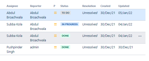

The JQL query looks fine. Problem might be with Resolution not being set on the issues. Please check that if the issues returned in the query have Resolution set or they are showing as "Unresolved" for "Done" status issues. In case they are shown as unresolved you may have to set the resolution then only it will appear as Resolved issues.

Yes, you are correct. I noticed that the resolution is not set as I see issues that are marked as in "Done" are still sitting under "Unresolved". Please see the screenshot below.
Could you please help me with how to set the resolution as "Resolved" for all "Done" issues, so on the graph, it will show Issues in "Red" that are unresolved versus in "Green" that are resolved? Thank you in advance for your help!

We need to set the Resolution for Done Issues. There are ways to do this one. Let me list out for you. But before that you may have to fix your workflow so that future issues don't end up like this. To fix workflow Navigate to that particular workflow --> In Edit Mode --> Add a Post function for transition that is going to Done for Set Resolution as Done(or an equivalent value in your instance). Please check out this thread where previously I had suggested a solution for similar type of issue https://community.atlassian.com/t5/Jira-Software-questions/Couldn-t-make-resolution-as-Done-for-completed-User-Stories/qaq-p/1897440
Now to set Resolution for existing Unresolved issues that are in Done Status.
1.  Try a "bulk edit", but you'll need to be very careful while doing this, as you have to put the resolution field on the edit screen to enable it, and if someone edits an issue while it is there, they may resolve issues which wouldn't have been the case for them.
2. If you have scriptrunner plugin you can bulk set resolution for the affected issues. You just have to save the filter(only for done which are marked as unresolved issues). Check out this post here which guides you how to do https://docs.adaptavist.com/sr4js/latest/features/built-in-scripts/bulk-fix-resolutions
3. In case you have automation for jira plugin write an automation to set the resolution. You may have to use "Scheduled" Event to this. The same which already I have mentioned in the above link  https://community.atlassian.com/t5/Jira-Software-questions/Couldn-t-make-resolution-as-Done-for-completed-User-Stories/qaq-p/1897440
