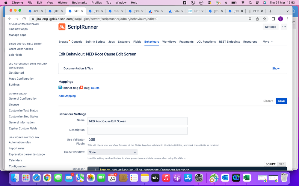

Hi Fabio,
please find the mapping screen shot and the problem is when i am trying to edit an existing Issue and then changing the Issue type to "BUG" then Root cause field is not becoming mandatory its still non mandatory.
Hi @shrikant maheshwari ,
that is the problem. You behaviour currently works just for bug. If you need to work for all issue types (mandatory field should depends form all issue types) you need to edit mapping so that it works at project level and for all issue types.
It should fix your issue.
Fabio
