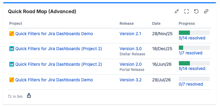

Hello @Nandhini M,
I am Marlene, product manager of Quick Filters for Jira Dashboards.
We recently released the Advanced Edition of our app which provides a Quick Road Map gadget. On top of the standard features, this gadget can be dynamically filtered using a Quick Controller.
You can check it out without installation on our demo dashboards.
