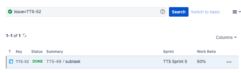

Currently my tasks have estimated time, start date and end date.
I would like to see the progress of each task expressed as a percentage.

Hello @María Acosta
If you have an Original Estimate value and you use the Log Work option to log time spent working on the issue, then you can see in the search results screen a Work Ratio field that shows you the percentage of time from the original estimate that has been logged.
For example if you have an original estimate of 1 hour, and you have used the Log Work feature to record that you have worked on the issue for 30 minutes, then the Work Ratio field will show 50%.
Other than that Jira does not have a native method for expressing percentage of work completed on an issue.
