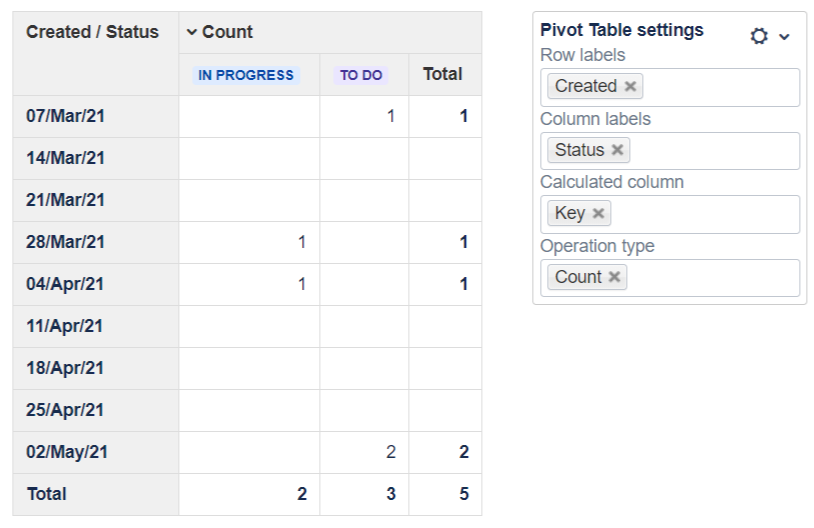

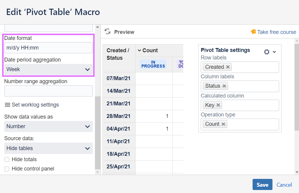

You may use the Table Filter and Charts for Confluence app to filter the Jira Issues macro, create pivots and real-time dashboards right in Confluence.
For example, for your case you may wrap you Jira Issues macro into the Pivot Table macro and create the required table (as we don't have different priorities for our project, I've chosen statuses instead but it doesn't matter - the macro works with all the Jira Issues columns and allows you to create different pivots like in Excel):
Hope this may help your case.

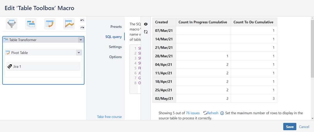

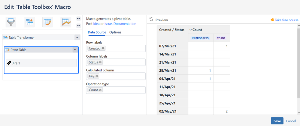

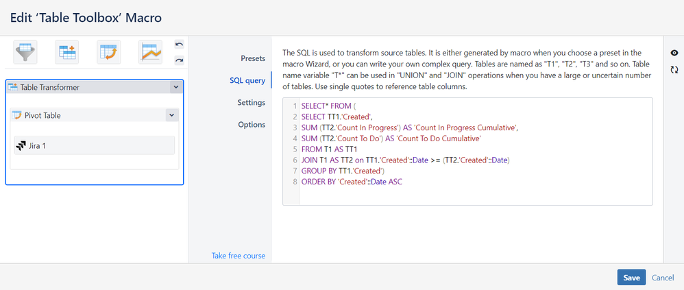

I can come up only with the following workaround - you may use the cumulative running totals.
Wrap your Jira Issues macro into the Table Toolbox macro and create a sequence Jira Issues <- Pivot Table <- Table Transformer macro.
The Pivot Table is the same table from the previous answer.

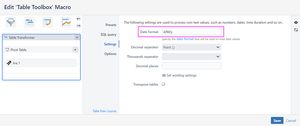

Then go to the Table Transformer macro and type in the following custom SQL query:
SELECT* FROM (
SELECT TT1.'Created',
SUM (TT2.'Count In Progress') AS 'Count In Progress Cumulative',
SUM (TT2.'Count To Do') AS 'Count To Do Cumulative'
FROM T1 AS TT1
JOIN T1 AS TT2 on TT1.'Created'::Date >= (TT2.'Created'::Date)
GROUP BY TT1.'Created')
ORDER BY 'Created'::Date ASC
And here is your result table with the running totals:
