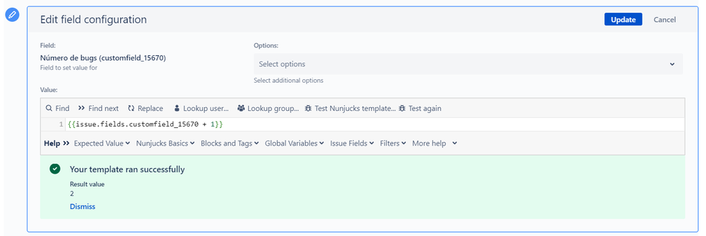

I have this automation configured with JMWE when I create a bug. My goal is to update the field "Número de bugs" with the amount of bugs an issue had. But using this value {{ issue.fields.customfield + 1 }}, it only adds once, It doesn't sum after the first bug, so in the field, always remains 1. What am I doing wrong?
Hi @Jaqueline da Silva Nicolau
since this post function is created on the Create transition, it will run whenever an issue is created, and add 1 to its "Número de bugs" custom field. But since the issue is new, it will always start with 0 (in fact, not even 0 but no value at all).
Can you describe what you're trying to achieve?
the information on top is hided, but the field "Numero de Bugs" is a field from the parent of the bug, and the automation is to set this field when (trigger) a bug is created
I see. In that case, you need to read the field of the parent issue, which is the target issue, and add 1. So the value should be:
{{targetIssue.fields.customfield_15670 + 1}}
