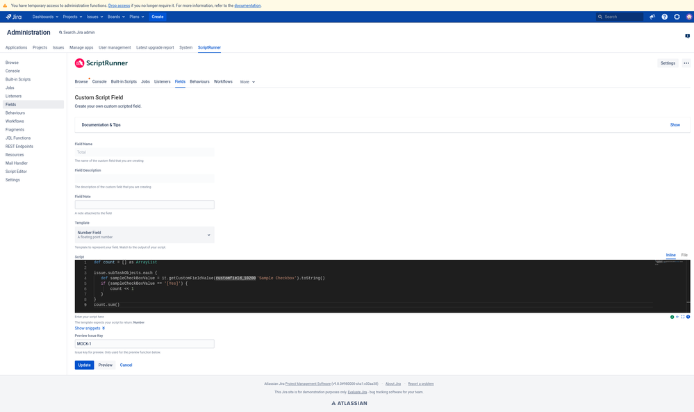

For your requirement, it would be best to use a Custom Scripted Field for the Agency Count.
Please ensure you are using the latest release of ScriptRunner so you can use the HAPI feature to simplify your coding.
Below is a sample working code for your reference:-
def count = [] as ArrayList
issue.subTaskObjects.each {
//Rename this custom field
def sampleCheckBoxValue = it.getCustomFieldValue('Sample Checkbox').toString()
if (sampleCheckBoxValue == '[Yes]') {
count << 1
count.sum()
Please note that the sample working code above is not 100% exact to your environment. Hence, you will need to make the required modifications.

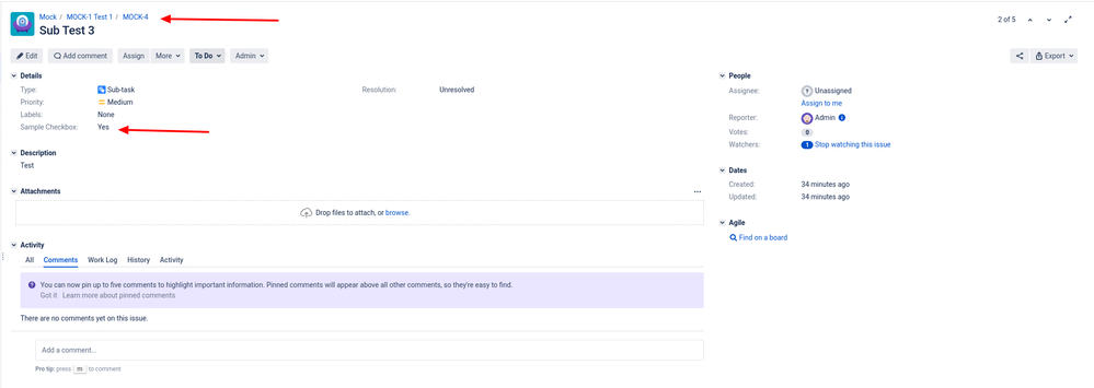

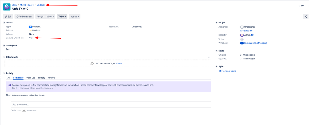

Below is a screenshot of the Scripted Field configuration:-

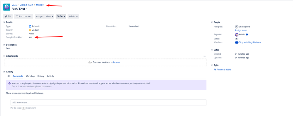

Below are a couple of test screenshots for your reference:-

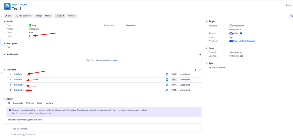

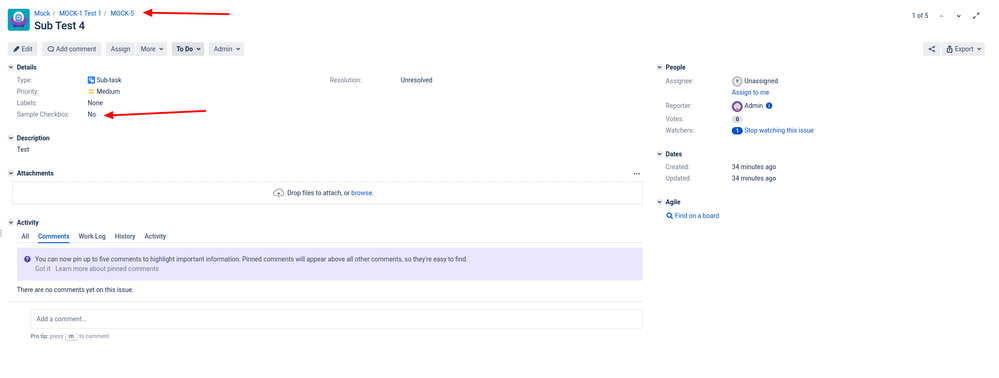

1. For the first test case, I created a Story and added 4 Sub-tasks to it. For the first 3 Sub-tasks, I selected the option Yes in the checkbox, and for the last Sub-task, I selected the option No.
As expected, the Total field (Scripted Field) in the Story issue returns the value 3 since 3 of the 3 Sub-tasks have been set to Yes.

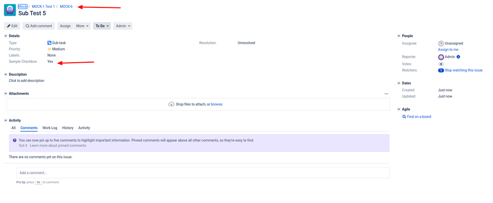

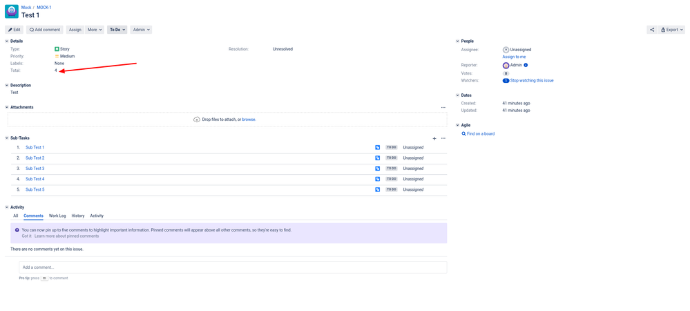

2. I will add the 5th Sub-task and set the checkbox to Yes for the next test case. As expected, the Total field in the Story issue is updated to 4. Below are the screenshots for your reference:-
