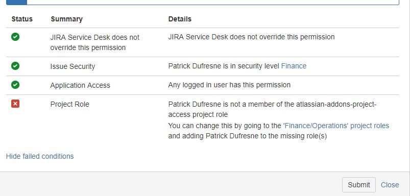

So I think I got most of it figured out, the only thing I don't get is "project role - "atlassian-addons-project-access""
Despite what it says I can add a comment. Should I ignore this? What does this mean? How do I remove this from being a condition? It's not a required condition for my issue security level so not sure why it's telling me this is an issue.
