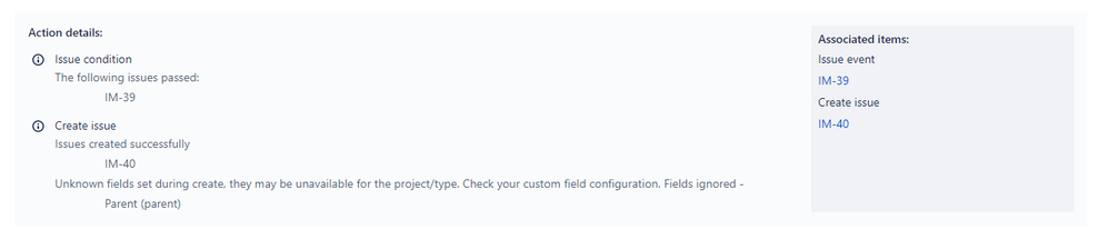

Please let me know if there are permissions I need to be aware of as when I try to create multiple stories it says "Unknown fields set during create, they may be unavailable for the project/type. Check your custom field configuration. Fields ignored - Parent (parent)"

This isn't really helpful because I have changed my rule so I am not sure how I had it configured but here is the error:
It created both my story and epic but did not link them - can someone please advise me on how the rule should look to create multiple stories (with subtasks) automatically underneath an epic when it is created?

Katie, I believe what is happening based on what you describe is the rule is getting confused by what "parent" is when you try to create the sub-tasks.
Focusing on just what you are trying to achieve, I have seen this solved with 1 or 2 rules. Here is the 1-rule way.
This solved it! I was looking for parent instead of epic link.
