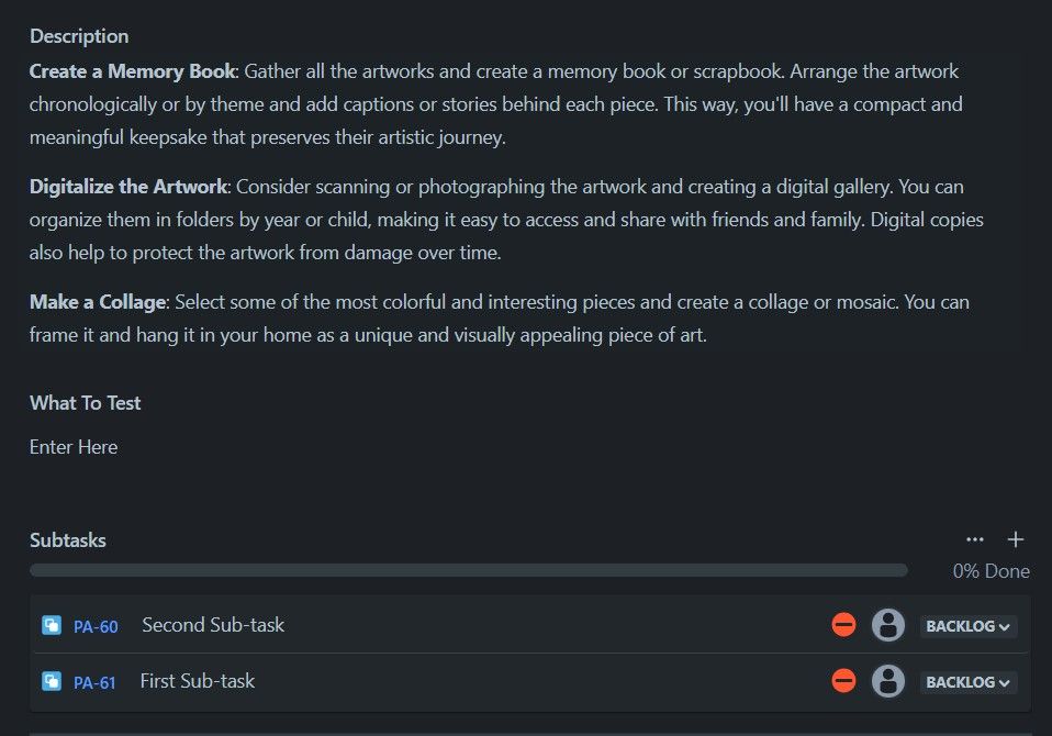

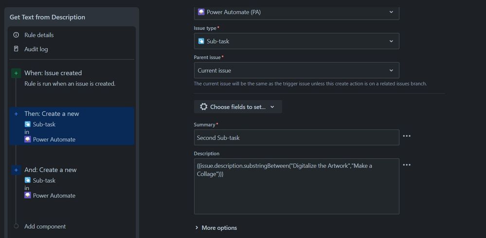

Hi @Hizkeel Khan Here is the solution, I have used substringBetween(String open, String close) to get Story Description data and copy in into Sub-tasks.
You have to split description based on your data, I have designed based on my description data :- https://support.atlassian.com/cloud-automation/docs/jira-smart-values-text-fields/

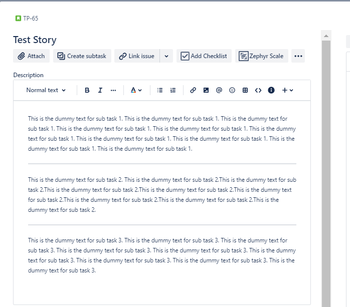

I am attaching SS for reference. Can we create the sub-tasks based on divider (horizontal line). This way I won't have to specify the description in sub-tasks every time while creating automation rule.

Hi @Hizkeel Khan Jira's smart values do not have a direct function to extract text before or after a horizontal line from the Description field. Use something string like ---- or ____
