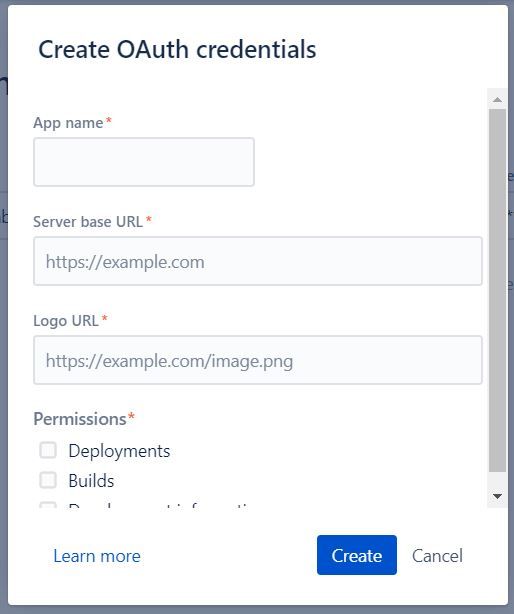

Is it possible to pursue a Jira authentication popup window were the user can enter their credentials and receive a token?
Christos Palaskas October 26, 2020
At phase one I am trying to access JIRA through the API from the browser, even with hardcoded passwords or API keys. I just need a proof of concept, the minimal way to make it work.
I am trying to follow this docu:
https://developer.atlassian.com/server/jira/platform/oauth/
but I get a different popup. Am I on the right path at all?
