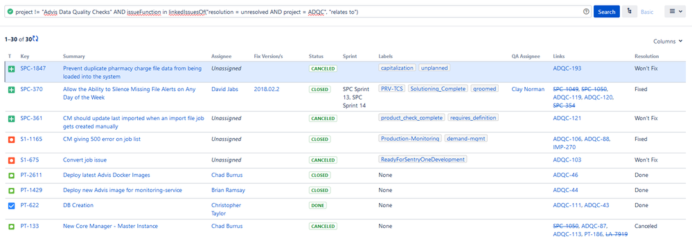

The query works to a great extent, however, not perfectly:
As seen in the screen shot, the resolution to be included are those that are "unresolved", however, the query picks up tickets which are "Fixed", "Won't Fix", "Done", or "Canceled". That is a problem.

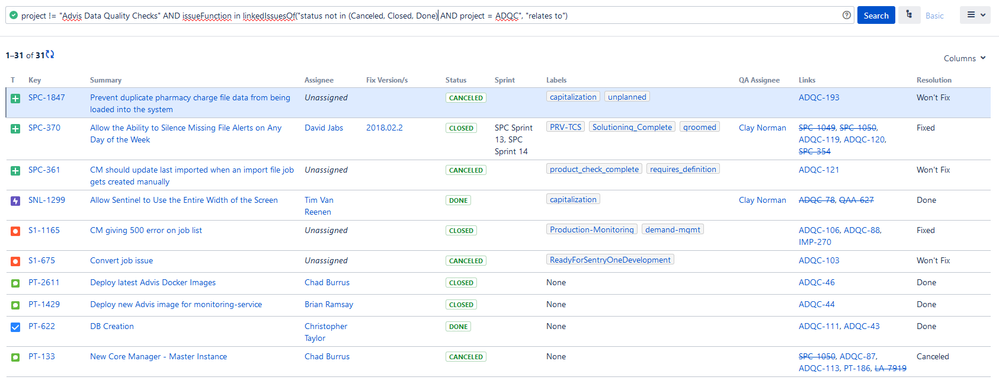

So I tried another approach to filter out the "Status" of ticket, but that doesn't work:
As seen, the <issueFunction in linkedIssuesOf("status not in (Canceled, Closed, Done) AND project = ADQC", "relates to")> is not filtering out tickets with the "not in" statuses as desired.
@Antoine Berryany thoughts or suggestions? I'm getting the results I want, but I'm getting a lot of noise as well which will only distract and confuse people who review the dashboard. Thoughts?
I think i just figured out my issue. I forgot the list which I am looking at. This list is showing the status of the initial "project = ABC" query. So the change should be:
(project = ABC AND Status not in (Closed, Done, Canceled)) AND issueFunction in linkedIssuesOf("resolution = unresolved AND project = ABC", "relates to")
This seems to have worked as I wanted.
