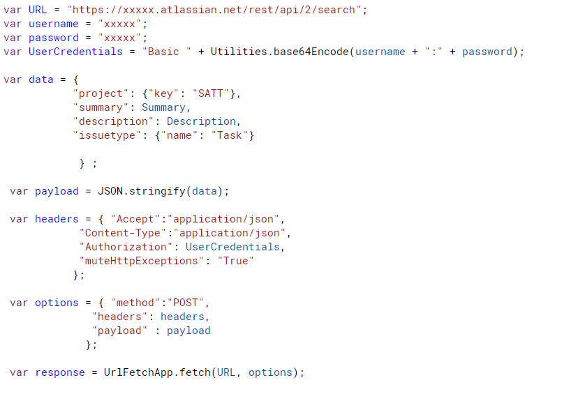

Does anyone know how to use information that you pull from your spreadsheet for your
var data = {"fields": ?
In general the script works. As soon as I add variables that refer to my spreadsheet it doesn't work though.
My code looks like this
