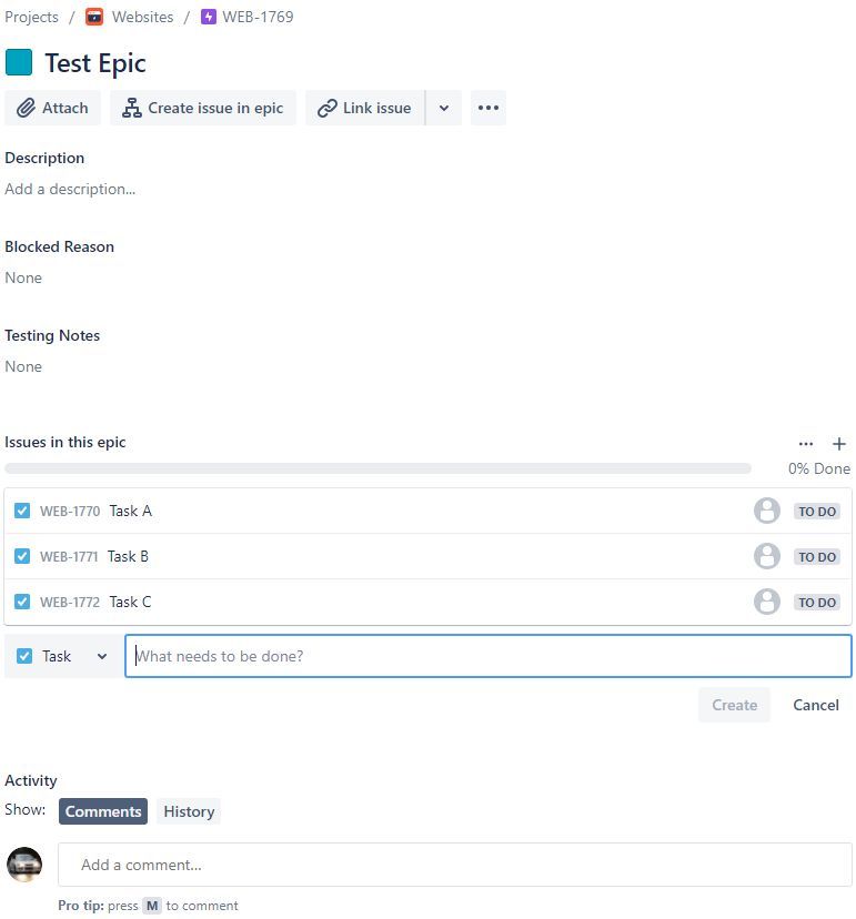

So to try and explain this better in the New Issue View, I just created a random new Epic in our Websites project as below. Ironically - and as if to antagonise me a little further, this screen does indeed have the 'Create another' option - which I would have thought would be a rare occurrence for Epics? Anyways, back to the view...
So the Test Epic is created and I go into it. It's here normally (and where I would expect to see) the 'Create another' option. So that when I start Task A, I can select that the Reporter is Bob Jones, that the Assignee is me, that the Product Owner is Tracey Roberts, that the Department Involved is Marketing, that the Priority is High, that the Financial Impact is Low, etc. I can then fill out the remainder of the task details within Task A. At the very bottom (similar to the Epic window above and as shown in my previous screenshot of the Old Issue View) - the 'Create another' tickbox was there previously.
So once ticked and creating Task B, all of the previous criteria from Task A is already populated - saving a considerable amount of manual time in adding detail to the tickets. Without this, both Task B and Task C are now completely devoid of any of the presets that I created in Task A and I now have to insert them by some other means.
The only way I've found around it so far is to create all the tasks within the Epic and then click on the three dots and go to Bulk Edit - adding required criteria to the several tickets already created. I guess it does work, but just changing the step to the end of the task creation rather than at the very start as seen in the Old Issue View.
Don't use the "Create issue in epic" button, but the big Create button on the top menu. You'll need to add the Epic link, but you can then use the checkbox 'Create another'.

@Julie d_Antin _Elements_ - thank you for that response - I've never even acknowledged that large Create but at the top before. As you say, the 'Create another' option is within that - which is exactly what I'm after.
