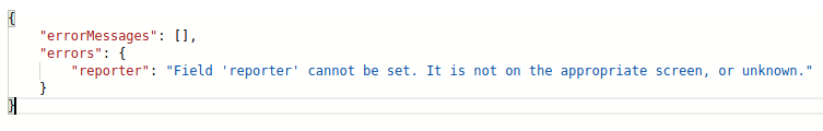

I am trying to use JIRA Rest API to create an issue in JIRA. I am seeing this error
"errorMessages": [],
"errors": {
"reporter": "Field 'reporter' cannot be set. It is not on the appropriate screen, or unknown."
I checked with the client and he says the user that I am using has the permission to create the issue. Client is using 4.X version? Please shed some light and any leads are highly appreciated.
Thanks in advance.

Hi Nic, not sure what I am missing here. We are able to create the issue successfully on the UI and were also able to modify the reporter. But using the REST API, still getting the same issue when we are creating --> {
"errors": {
I would really appreciate if you could suggest me what we are missing here?
