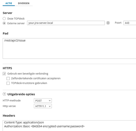

kaymoonwitch May 28, 2019 edited
@Steven Breton van Groll
Well, I did end up figuring it out.
Turns out it's not Jira; it's TOPdesk. Basically, the HTTP Request gets appended with a '?' messing up the entire setup. I have no idea how you got it working, unless we are indeed running very different versions. So I resorted to using https://jira.server/rest/api/2/issue as Server and using expand=names as 'Initial Line'.
TOPdesk just logs 'HTTP request Failed'. But I am now able to reach Jira, I believe. (I can't access the logs for it.)
So even though I gave it my best, TOPdesk has me beaten it seems.
May 28, 2019 edited
@kaymoonwitch
I used the old manner of creating JIRA issues also with the old TOPdesk-version.
With these config it should work:
Body:
"fields":
"project": {"key": "[JIRA ProjectKey]"},
"summary": "[Korte_omschrijving_(Details)]",
"description": "\J[Verzoek]\j",
"reporter": {"name": "[JIRA-user with needed permissions]"},
"issuetype": {"name": "Bug"},
"customfield_10300": "[Incidentnummer]",
"customfield_15300": "[Aanmelder_(geregistreerd)]",
"customfield_15301": "\J[Actie_(alle)]\j"
Make sure that TOPdesk sends input for all the required fields of your JIRA-project. This depends on the config of your JIRA-project. You could check this at the create issue screen of your project in JIRA.
Port 443 from your TOPdesk-server to your JIRA-server has to be open.
Hey @Steven Breton van Groll ,
Thank you for still responding to me. I really do appreciate it.
I have it configured exactly like that, but I've noticed that TOPdesk sends the following http request:
https://jiraserver?/rest/api/2/issue A question mark is inserted, which throws off the entire thing. Could be a bug in the ancient version we're running.

kaymoonwitch May 27, 2019
I realize this is an old thread; and I do apologize.
The company I work for is still using TOPdesk 5.4 SP1, which means we can't use the new API.
I've configured an HTTP request;
Server: jira.server.local Port 443
Initial Line: POST /rest/api/2/issue HTTP/1.1
Headers
Content-Type: application/json
Accept: application/json
Authorization: Basic <encoded credentials>
Message
"fields": {
"project":
"key": "MON"
"summary": "TEST [Incident_Number]",
"description": "Creating an issue via REST API and topdesk",
"issuetype": {
"name": "Bug"
"reporter": {
"name": "my name"
 It seems TOPdesk prepends http:// ; is there something in the Jira setup I am missing?
