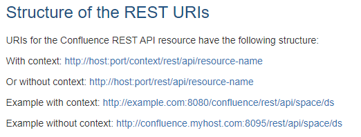

At the top of the documentation it is mentioned:
Tried your suggestion, but then I only get a "page not found".

The confluence rest api documentation has not been updated since 6.6.0
