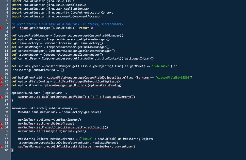

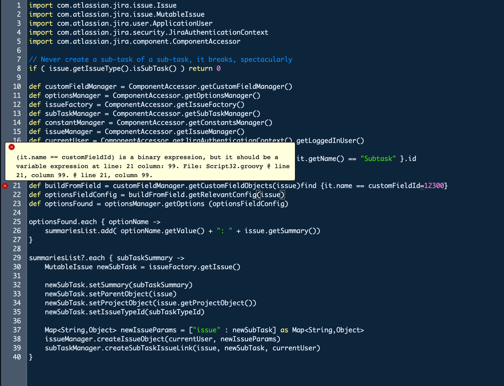

DQ DevOps June 2, 2020
I've just made a change to remove the speech marks from the customfieldID and its giving me the following error
Nic Brough -Adaptavist-
June 2, 2020
I'd say it's not finding an issue type named "Subtask"
