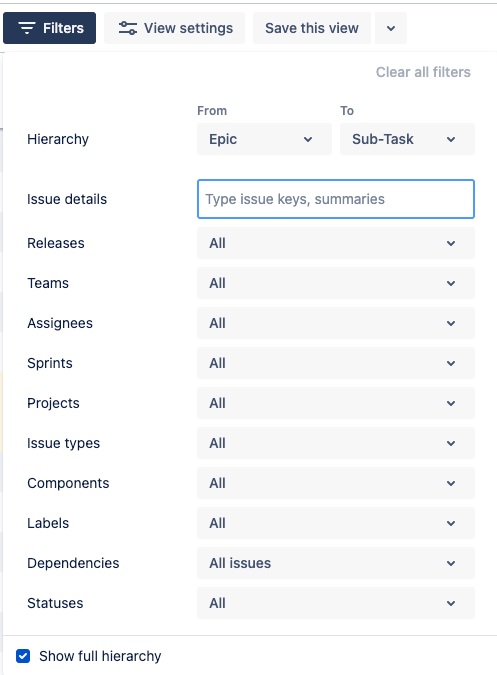

Hi @Omar Erminy
Thanks for coming back to me - strangely I don't see this option here at all.. I attached a screenshot to check I'm looking in the right place?
You are right, although I am not sure if you are in the Roadmap view. It could also be the case that this is different from version to version. We have the on-premise version. Maybe the cloud version is different.
At least from that screenshot you shared, mine looks slightly different.
Sorry I can't be of more help @Harriet King.
I have had some success achieving what you describe by using the dependencies filter.
See the below screenshot. You will want to choose Dependencies, then select Specific issue and then find the Epic you want to filter to only see it and its child issues (what i blurred from our instance). Note this is in JIRA cloud where its available.
You will then be able to see only that Epic and its child issues in your plan and then you can save that view. Note however the child issues will show slightly "greyed" (as if the filter should include whats under them - which seems like a bug to me).
