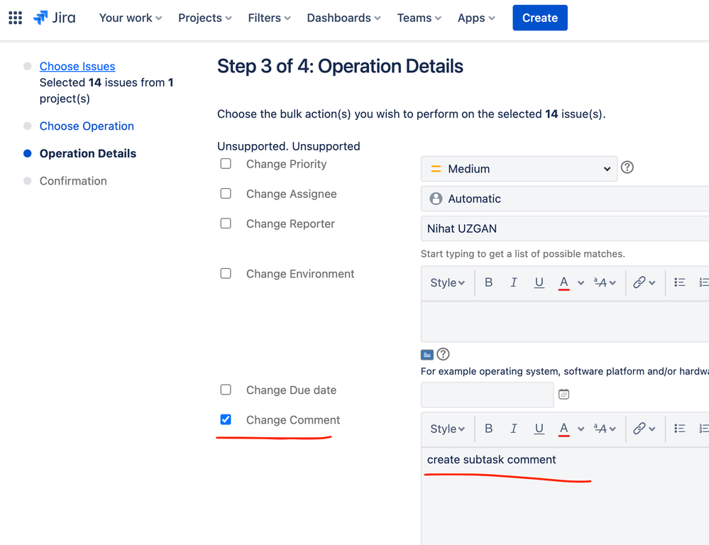

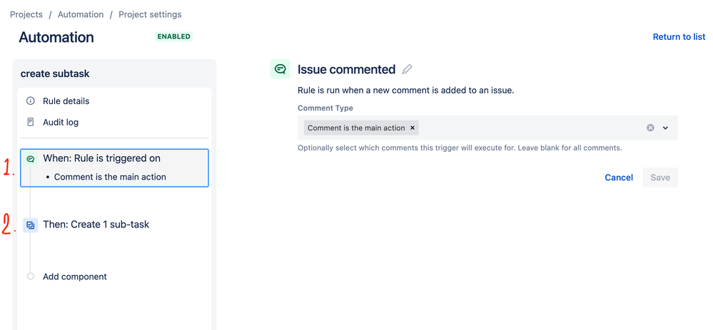

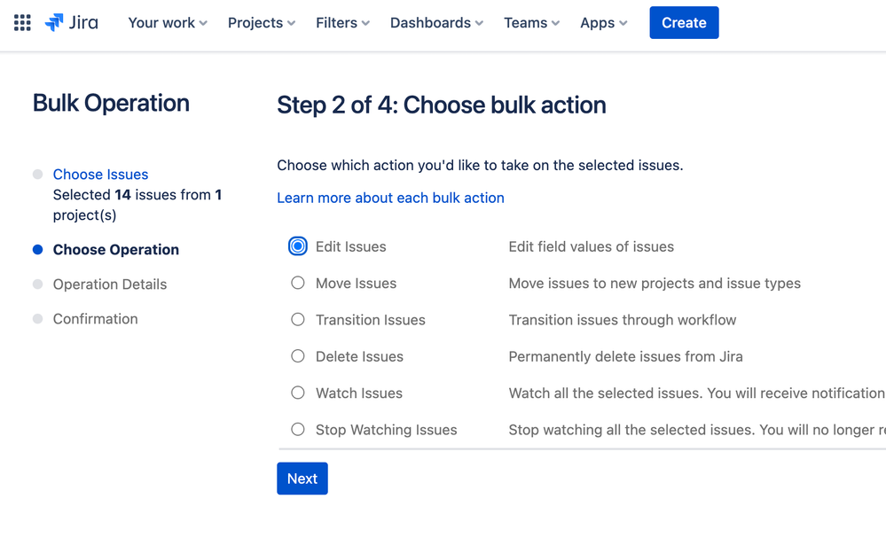

Hi @Swaroop Kumar ,
I can offer you a workaround. Create an automation using Automation for Jira, in the first step put a condition that will run when a comment is added. in the second step put the action to create subtasks and write the summary that will be the same for all of them. Then select the 150 issues you mentioned with bulk change and add the comment by clicking edit issues. This will create sub-task in all issues where comment is added
You can change the condition you will put in the first row according to yourself. If you want, you can add an empty transition to the workflow and prepare an automation that will run when this transition is triggered. Then you can trigger that transition in the issues you select via Bulk Operation.
