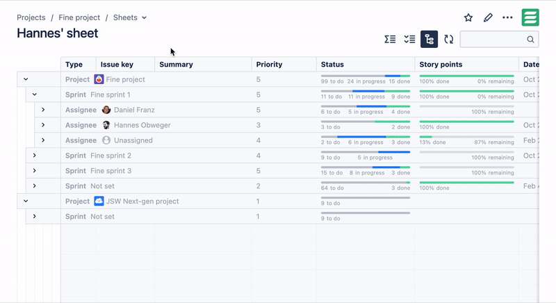

I can also see you getting pretty far with the app that my team is working on, JXL for Jira.
JXL is a full-fledged spreadsheet/table view for your issues that allows viewing (and, where it makes sense, inline-editing) all your issue fields. It also supports grouping your issues based on any issue field, plus calculating sum-ups across these groups of issues. If needed, you can export the resulting issue structure to Excel/Google Sheets for further processing.
Here's how issue grouping looks in action; in your case, you will want to group by different fields (such as "Squad" and "Project"?) and view other fields (such as your story points), but that's very easy to configure.
Hope this helps, and please don't hesitate to reach out if there's any questions!
