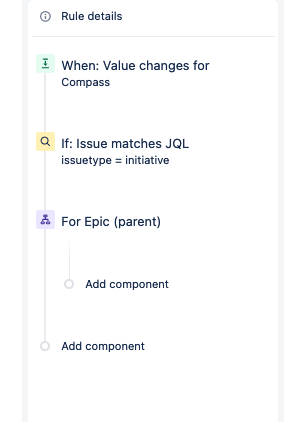

Here is how I would setup the Automation.
Could you try an Automation set up as follows, changing the field in the first section and also adding an Action under the branch "For Epic"
The "For Epic (parent)" only works for the issues under an Epic. In order to get the children of an Initiative you have to JQL for "Parent Link" = {{issue.key}}
