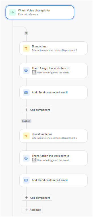

Hi Jennifer and welcome to the community!
Yes, you can create that using Automation with the limitation that you only can assign issues to one individual.
I guess Department A, Department B are custom fields?
Then create a If/Else statement checking when the field value changes and base the If/else on the value of the Department field. In the example below I called the Department field "External reference"
You can send the mail to several people.

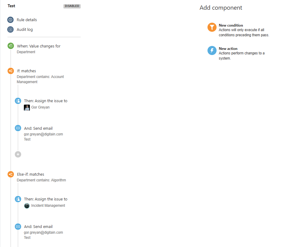

Hi @Jennifer Ness
Yes, you can do it with Automation, using If/Else blocks and setting conditions, for each department and setting actions after each condition.
If you want, I can provide an example with a screenshot.
Thank you, Gor.
A screenshot would be lovely here. I'm just finding my footing...
Dear @Jennifer Ness
Above, I provide Screenshot, here, I will provide detailed information.
1. First, you should set the trigger, it is when the automation should start to work.
I put there "Field Change" trigger, which is starting to work, when the Department field is changed.
2. You should set conditions. I used If/Else blocks.
It is checking if Dthe epartment is, for example, Account Management
3. Action- Assigning the issue to Gor Greyan and sending an Email to the appropriate person.
Then you can put an else condition, to check another Department and assign/send an Email for that one.
Let me know if you need further assistance.
