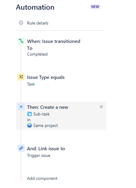

At its basic form, you could use something like this - and make modifications as needed.

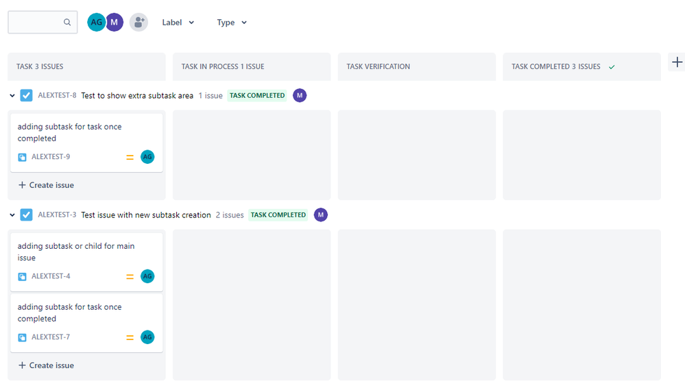

Hi, so both of these actions worked for what was needed, thank you so much! However, it created two different boards for the subtasks. Is there a way to fix that? I would like all subtask to show together if possible.

Yes, this is a pretty straightforward automation rule.
  • TRIGGER: Issue Transitioned (To your Resolved status)
  • ACTION: Create Issue

Based upon your response, You would use the Create Issue action as mentioned above and set the issue Type to Sub-Task or even use the Create Sub-Task action.
