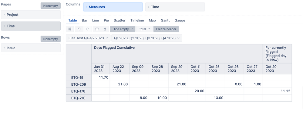

This is how your report might look:
Hopefully, this works for you, but feel free to let me know if you have any follow-up questions!

Kris Olds November 1, 2023
Hi @elita_kalane
This looks to be exactly what I was after, thank you very much!

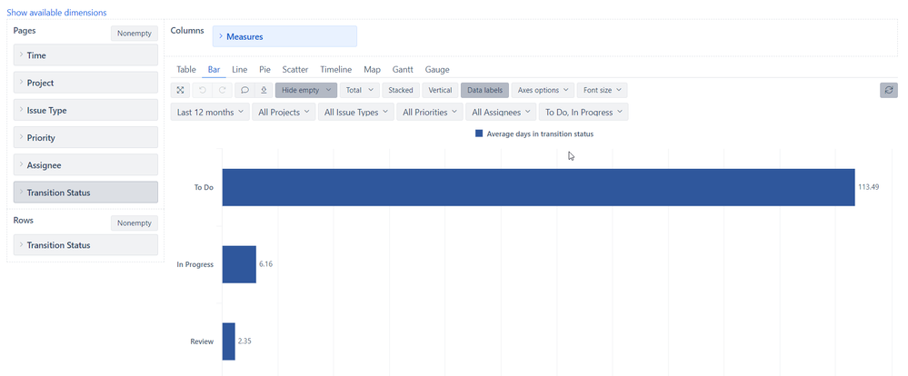

How this can be achieved depends very much on what you mean by a flagged status. If you can explicitly identify these as specific statuses, you can definitely build a report based on the out of the box available transition status.
This sample report in the EazyBI demo account for Jira Software illustrates how that may work:
