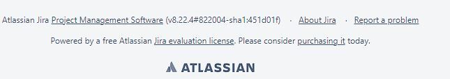

Aaron Pavez _ServiceRocket_
October 31, 2023
Hi @Suvarna Vellanki
You can find the version in the UI at the bottom of the page or in the About Jira button (same location)
And under Administration -> System -> System support > System Info -> Versions
Viewing your system information
Regards
