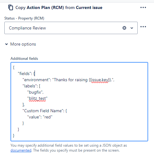

We have two custom fields that appear at the Epic and Story level but will not carry over to the subtask level. In the automations, these two fields do not appear as options when selecting fields to set. The fields are already added to the Subtask Issue Type, so that is not the issue. Is there custom HTML coding that can be added in the text field under more options, additional fields, or a better alternative? The fields are labeled "Compliance Lead" and "State Manager".
Hello @Brittany Montgomery
You can use More Options > Additional Fields area to supply JSON code for editing fields in the issue. The documentation for Advanced JSON editing can be found here:
https://support.atlassian.com/cloud-automation/docs/advanced-field-editing-using-json/
What is the field type for each of these custom fields? If we know what type they are we can assist you with figuring out the correct JSON code.

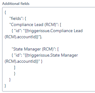

Hi Trudy,
The good news is that we were able to have the first part of the JSON code working correctly, but when we tried to insert the State Manager field, the automation failed. Can you tell me how to add multiple fields with the JSON formatting? Thank you!
When your automation rule fails, please provide the output from the Audit Log for that execution of the rule. Valuable information is available in that log.
I believe this is the code that you need:
You incorrectly added a comma at the end of line 4, and omitted the required square bracket and comma on line 5.
"fields": {
"Compliance Lead (RCM)": [
{ "id": "{{triggerIssue.Compliance Lead (RCM).accountId}}" }
"State Manager (RCM)": [
{ "id": "{{triggerIssue.State Manager (RCM).accountId}}" }
Hi Trudy - I apologize for not including the audit log on my previous inquiry, but this time it worked perfectly with your coding correction! Thank you so much!
