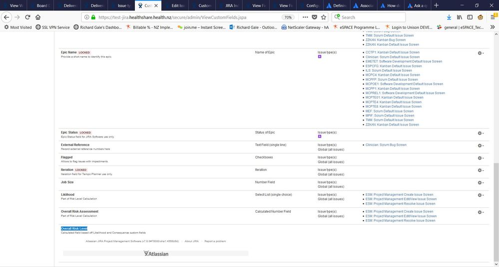

Was doing some work following https://plugins.atlassian.com/plugin/details/27136?_ga=2.68533269.561423346.1531273495-2122636972.1498681592
And inserted some code into the description box.
The issue is the custom list now seems to be broken as per screenshot
See 'Overall risk assessment' doesnt have config options and nothing below it?
What I have tried:
Clicking 'back' and removing code
Restoring from backup
However the backup doesnt seem to have removed the custom field list?

What happened is, you didn’t properly close the html comment in which the formula appears, which in turn broke the Custom Fields page.
If you look inside your JIRA log file (atlassian-jira.log), you’ll see ERRORs about that field followed by a URL. Navigate to that url to go to the Edit screen for the custom field, where you’ll be able to fix the formula and the html comment. Just close with -->
