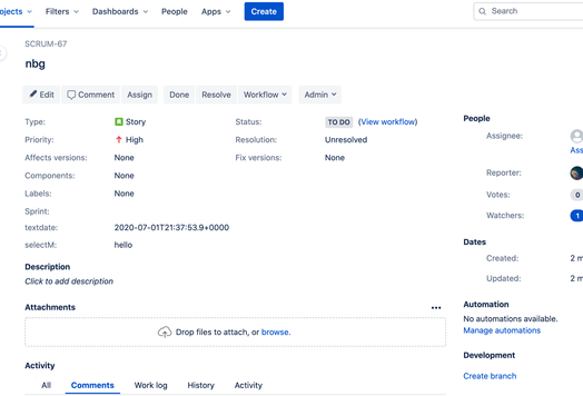

You can create a new automation rule in that project and you will probably want to pick out a smart value, such as one of the date/time functions.  I don't know of a specific means to convert a date/time value into just a numeric field.  I think there is going to be some loss of the date/time value there in the process.  However I was able to set a text type custom field with automation and set that value to be the current time.  Since my trigger is when issue is created, that date/time is set into that field by automation.  My rule looks like this:
And in turn my issue looks like this:
Where my textdate field is set to get that smart value from automation.
