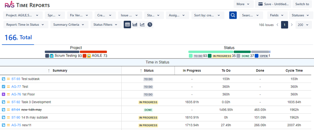

Madhu_RVS
April 12, 2023
Hi @Ben Glasthal
If you are open for a mktplace app, you can try out our plugin,
Time in Status Reports
The add-on provides the time in each status for the entire lifecycle of the issue, based on the date range, assignees and multiple other filters.
You can also group your statuses to define your own resolution time.
The app is free upto 10 users
Disclaimer : I work for RVS, the vendor for this app
