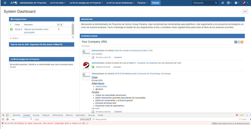

Hello, I am getting the following in my system dashboard (start screen):
Failed to load resource: the server responded with a status of 401 ()
and seems to be coming from:
http://x.x.x.x:8080/rest/analytics/1.0/publish/bulk
The screen menus do not seem to finish rendering since they have tags visible such as "<u>H</u>ome".
I looked around for a solution but those I found seem to refer to old Jira versions.

I do not believe that an error on that rest endpoint could cause the problem you are reporting here.  My thought is that this error too might be correlated to the source problem. But I am also not 100% clear on the problem you are seeing here.
  1. Could you post a screenshot of the error you are seeing?
  2. What version of Jira is this?
  3. When did this problem start?
Sylhos March 15, 2018
Capture.PNGHere is a screenshot.   I get inconsistencies for the same user avatar and the menu rendering.  I temporarily disabled the cache to make sure I was getting the latest from the server, but the problem occurs with and without it.   Thanks for the help.

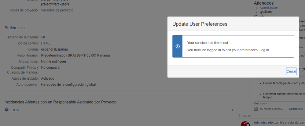

In terms of language, the system's default language is English, but my Admin user preference is set to Spanish.  When I went to the profile section to change it I get a "Your session timed out" error every time I click on the edit button near the preferences.
I assume there is a way to can change the language directly on the database?

Andy, I forgot to mention.  The menu artifacts show everywhere, but I have only seen the POST error in the Dashboard (start page).

Thank you for explaining all of that.  With this information I was able to try to switch my Jira 7.8.0 instance into Spanish.  The place to do this is a bit different than the user profiles: It is explained in the documentation Choosing a default language.
Only when I put my system into Spanish, do I too see these HTML tags in the menus.  This is clearly a bug.   Please see https://jira.atlassian.com/browse/JRASERVER-66829 for details.
