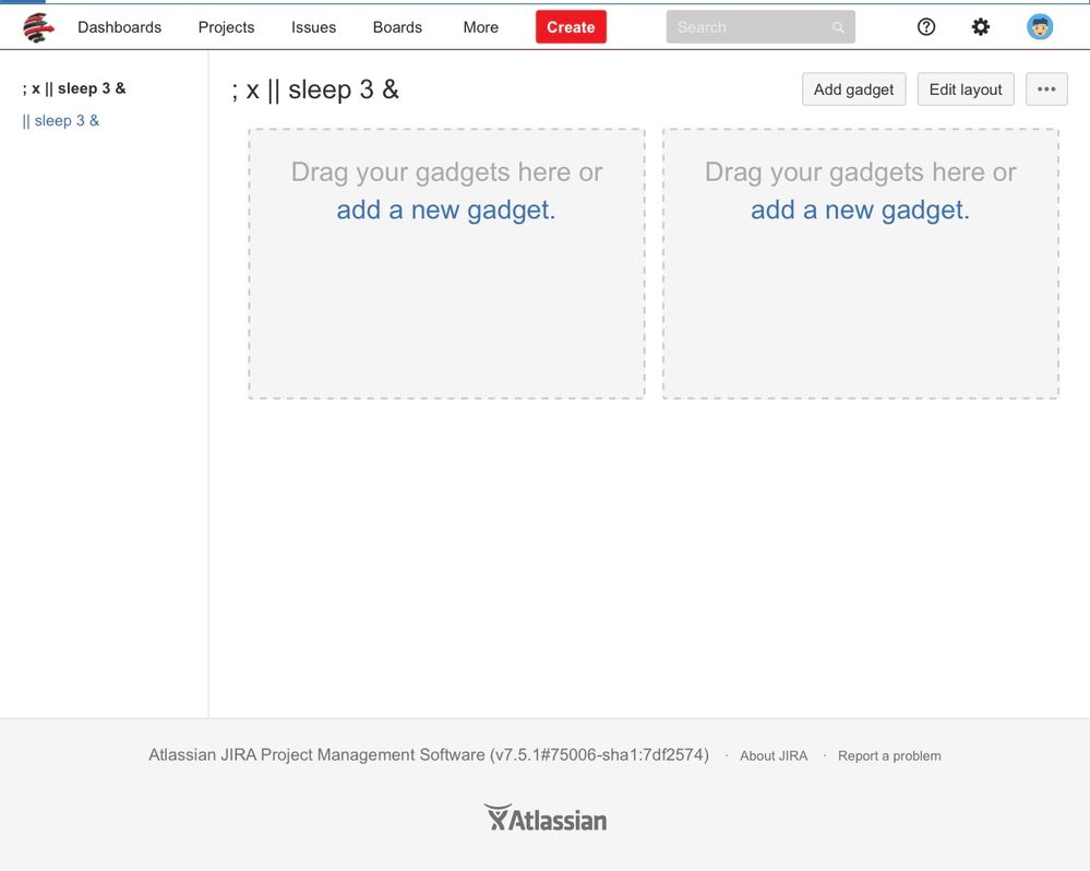

Jesse Borden (Jay) October 18, 2017
I have to keep deleting odd dashboards in order to get my system dashboard to function. The system dashboard will show “; x || sleep 3 &” in a few spots with empty gadgets, but when I delete this dashboard my original working dashboard will come back to life. I need to remove this spontaneous dashboard every day and it’s annoying and worrisome for anything else that might come later spontaneously.

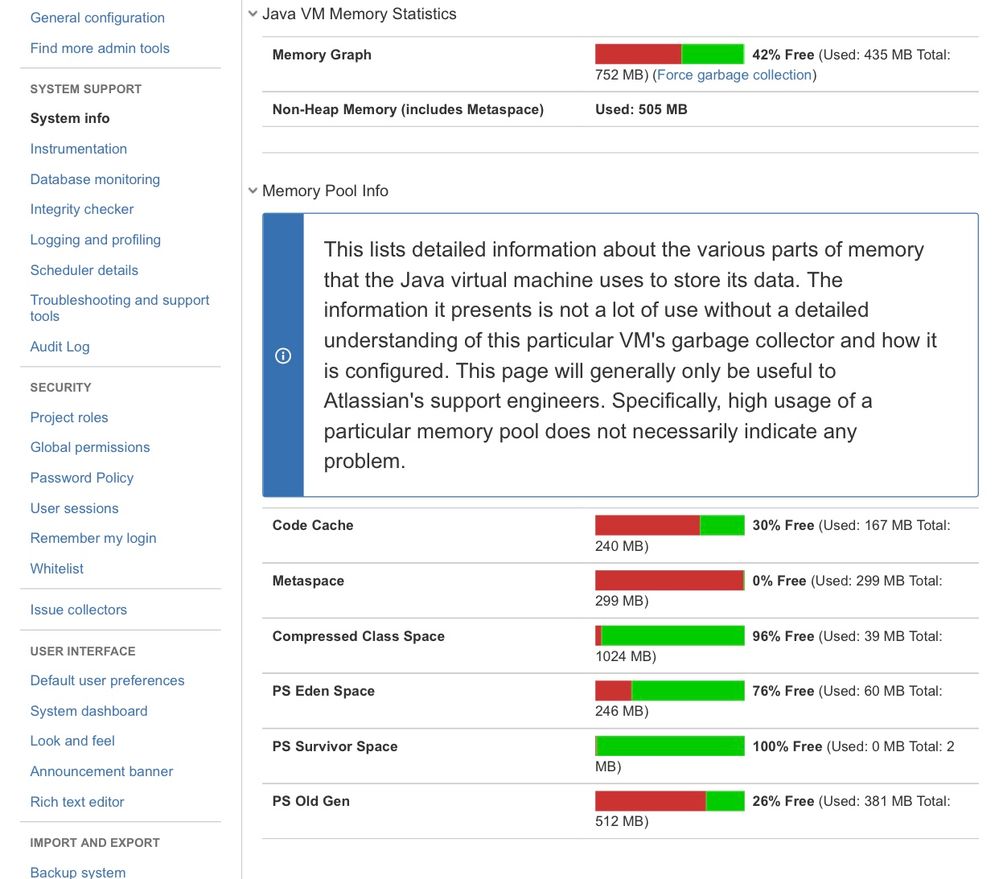

Have you gone into the system to review things such as Java virtual memory?
Yes, everything is at least 26% Free, except for the metaspace which shows 0%.

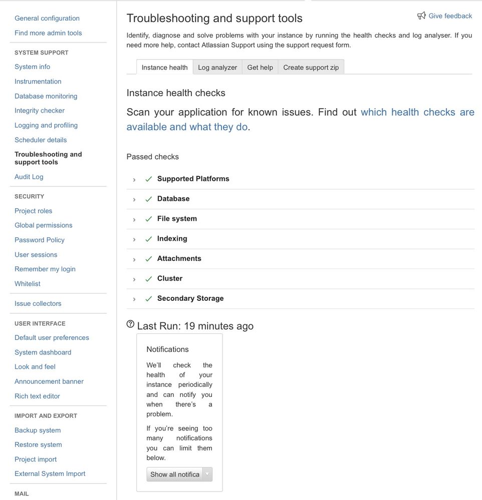

All integrity and health checks pass in JIRA.

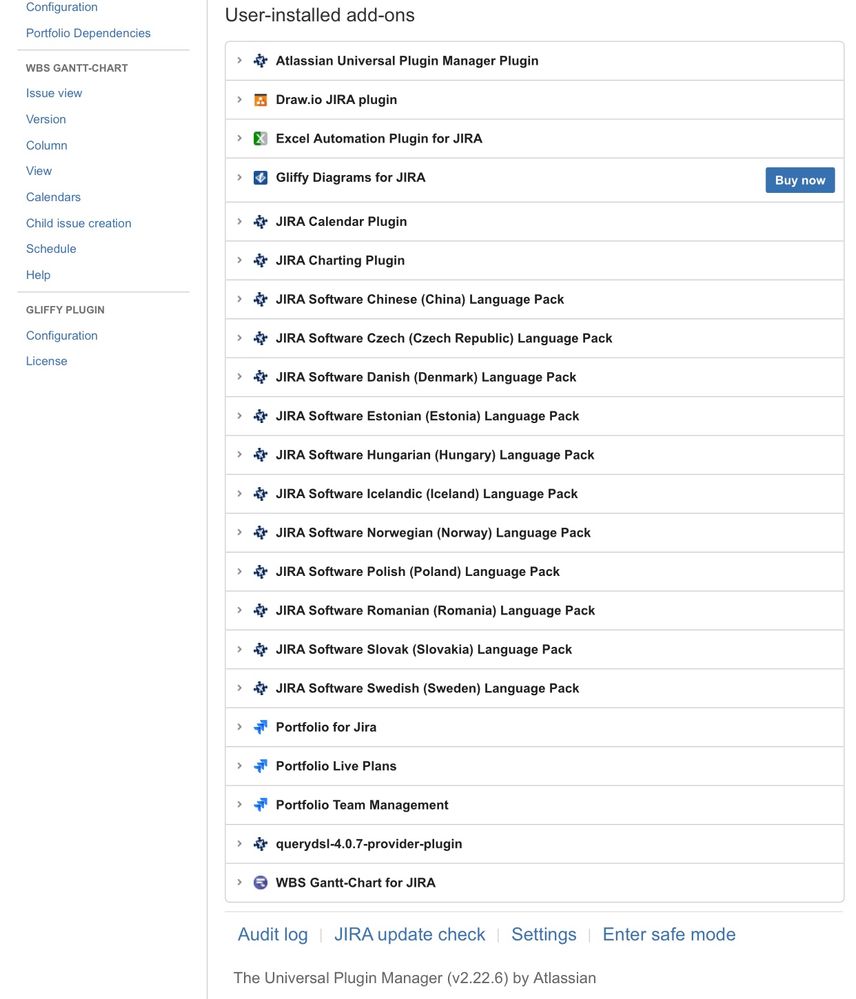

I first noticed the issue around the time I installed the Git Integration for Jira plug-in, but even after uninstalling that, the same issue still comes up.

October 21, 2017
Metaspace is as designed to be functioning at 100%
Can we take a look at the default dashboard settings?  Lets see if there's any gadgets that weren't removed from the git integration add-in.

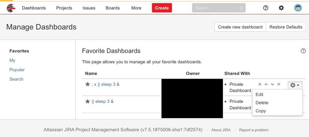

Everything there looks normal. No Git remaining. Less than 20 gadgets. Perhaps this is a database issue?
These two dashboards keep getting spontaneously created. When I deleted these, everything goes back to normal....

Jesse Borden (Jay) October 23, 2017
I selected restore defaults under Manage Dashboards, then ran the vacuum and indexing directly from the database. I tried that before without selecting restore defaults first. 1 day so far without issues. Too soon to see if that fixed it.
