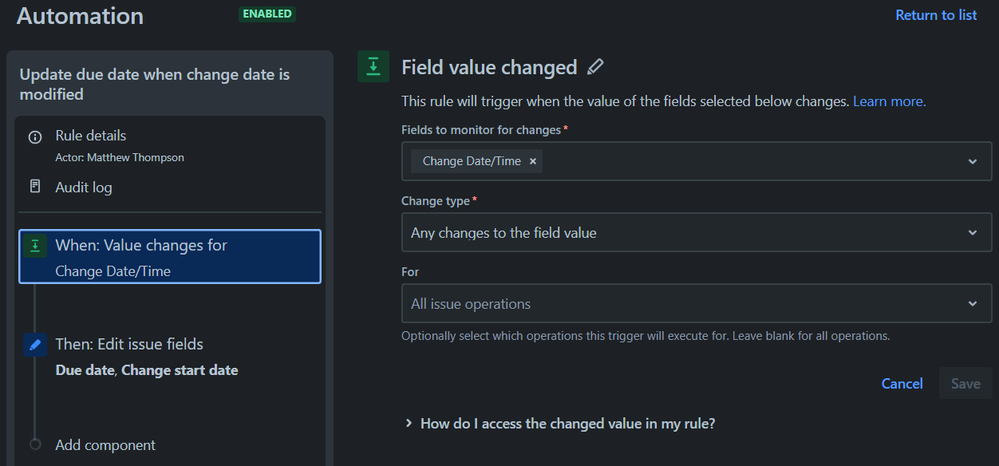

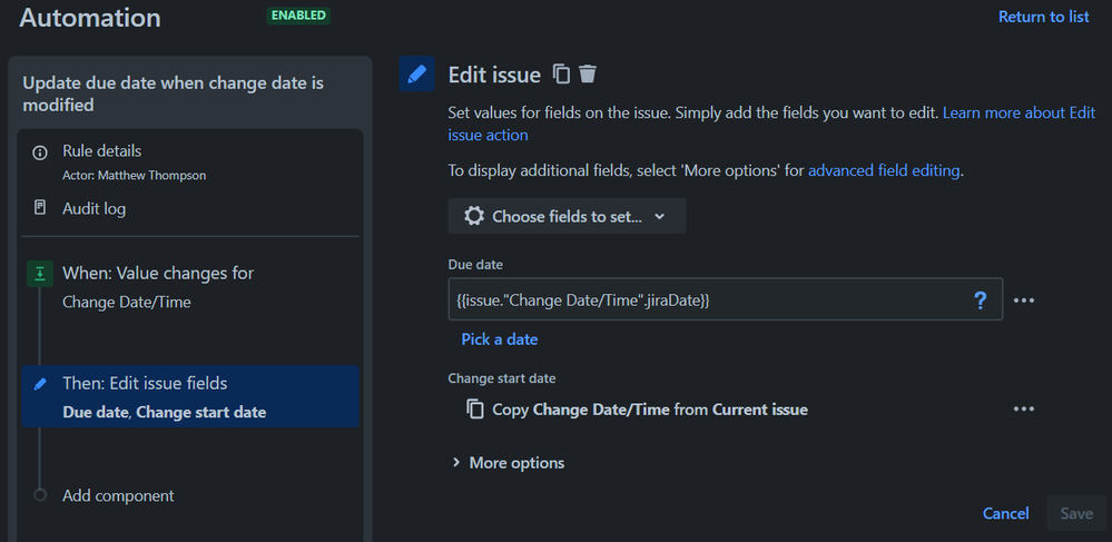

Marc Thomson
August 24, 2023
Here's the rule config:
Bill Sheboy
August 24, 2023
What is the time zone setting for your personal settings, Jira profile?  How does that value compare to where you are located?
Marc Thomson
August 24, 2023
GMT -6, which matches where I'm located.
Bill Sheboy
August 24, 2023
Thanks for that information.
Can you also show how you tried to force to your time zone as part converting/copying the field from UTC date/time to just date (jiraDate)?  Doing that should have gotten to the correct date before removing the time component.
