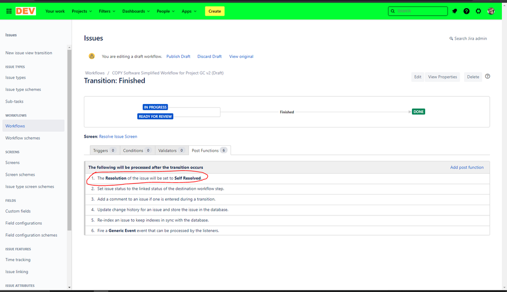

To test, I tried the following on my dev instance without success. What did I miss?
I added a post function, selected 'Update issue field', 'Resolution' = 'Self Resolved'
Created a new issue, moved it to 'Done' but it still shows system default resolution value.
Screenshot below, thanks for helping!

I appreciate the help but I must be missing a step. I added a post function on a closing transition and tested it with multiple tickets issue types, created a new workflow and added the post function but no success. Is there step by step documentation you can direct me to?
John Funk
December 2, 2020
When you say no success, what does that actually mean? Do you get an error? The value is not updated? It is overwritten by something else?
Take a look at the history of the issue when you move it to Done to see what updates it is doing.

@John Funk Good catch. Issue history shows the user picked resolution is being overridden by the post function.
Clarifying the request:
User wants the resolution default set to "Unresolved" when they create the ticket. That's what's confusing me. Everything I've found only shows doing it when closing the ticket. Possible?

Not sure what's happening but the post function (below) is not updating the resolution field per the instructions above. It still shows the system default resolution value. I reloaded the project page multiple times and create several Bug and Task issues.
Could it be a bug in Jira Software Cloud (Free)?

I suspect you need to move it up two levels - set the resolution before creating the issue.

HE SHOOTS! HE SCORES!
Below are the post functions in the correct order! Successfully tested on multiple tickets! Now the resolution is set to something that the manager wants when users forget to change the resolution when closing the ticket.
This has been a long journey, full of twists, turns, ups and downs. Times like these I remember the quote of my old zen master Patches... "If you can dodge a wrench, you can dodge a ball."
Thank you for sharing your knowledge and expertise!
@John Funk @Matt Doar @Mikael Sandberg @Am D  @Nic Brough -Adaptavist- @
  1. Creates the issue originally.
  2. The Resolution of the issue will be set to Cannot Reproduce.
  3. Stores updates to an issue (no change history is created).
  4. Re-index an issue to keep indexes in sync with the database.
  5. Fire a Issue Created event that can be processed by the listeners.
