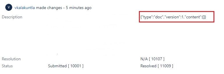

I am getting a weird issue in Jira cloud. We have imported content from Clear Quest to Jira cloud. Imported fields with content including description field. we are consuming Jira REST API urls for attachments and state transitions.
Here when we are doing state transitions (Submitted to Closed) , when the transition is done , Description field data is clearing . I am not updating desc from input json.
Is this manadate to update the description field from state transitions input JSON?

Thanks for your reply. Pls find the below request details.
When i do these transitions (Submitted --> Resolved, Resolved --> Closed) Desc is getting cleared. But all other transitions are working fine without any issues.
