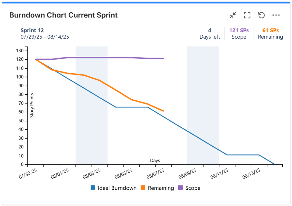

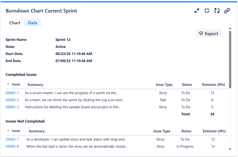

A simpler way would be to use an app from Atlassian Marketplace that provides the info you need.
In case you want to try an app for this, our Great Gadgets app offers a Sprint Burndown Burnup Chart gadget that could be helpful for your need.
On its Data tab, this gadget displays a report similar with the Jira Sprint Report.
This report can be exported in CSV format.
Danut.

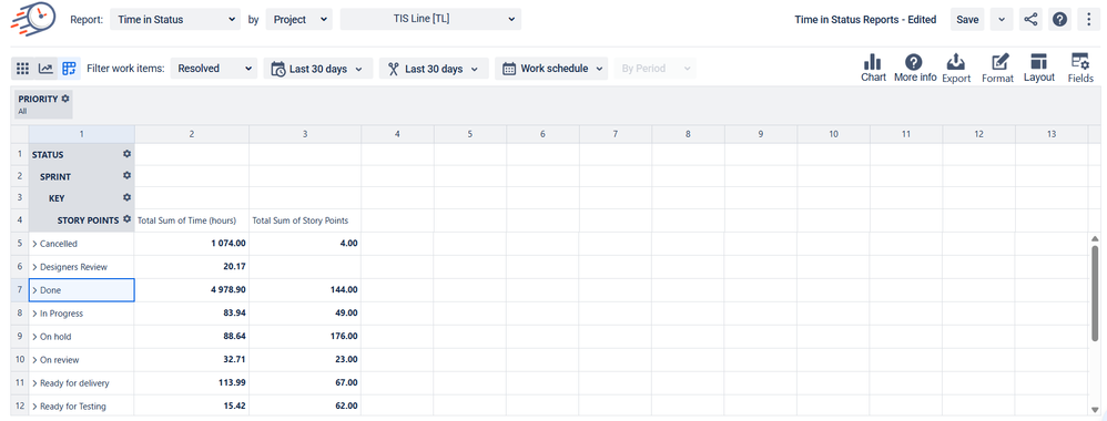

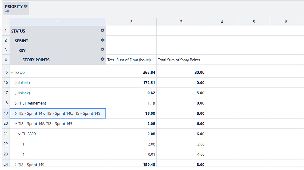

Hi @Maxime Besson ,
I was intrigued by your use case and recreated it in our Time in Status app, which supports a flexible Pivot configuration. Could this setup work for you?
Select scope
Project: chosen project
Filter: issues updated in the last 30 days
Set Pivot rows (in this order): Status → Sprint → Key → Story Points
Status shows the issue’s current status.
Expanding a Status reveals all Sprints in which the issues occurred during the selected 30-day window.
Key is the issue identifier.
Story Points can display multiple values if they have changed over the life of the issue.
Note: A blank value in Sprint or Story Points means the issue wasn’t in any sprint or had no story points assigned, respectively.
This view lets you track the history of changes over a chosen period and how issues moved between sprints.
Another feature, Sprint Report, also shows Carryover—the percentage of work that rolled over from the previous sprint into the next.
I hope this is helpful!
