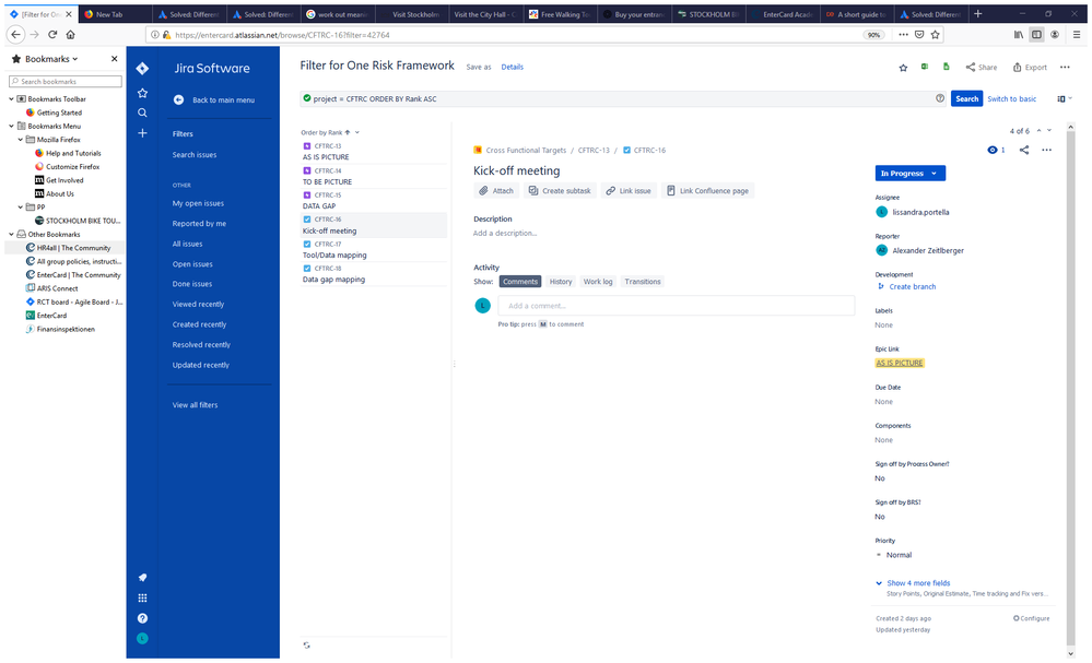

Hi, I have created the filter called Board in another place instructed because I could not find the fields to write the JQL. Let me show you:
BOARD FILTER CREATED

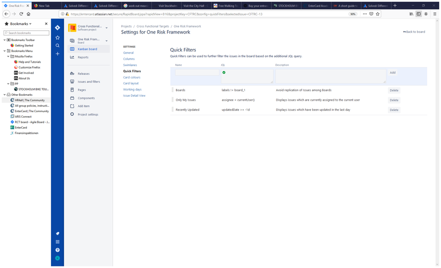

WHERE WE HAVE TOLD ME TO WRITE THE QUERIES

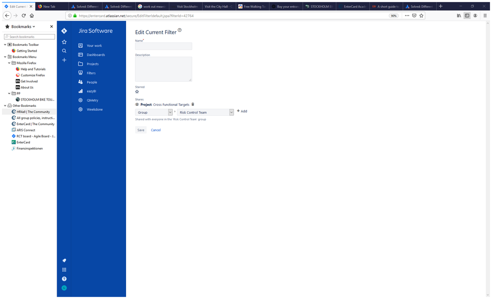

ANOTHER PLACE FOUND THAT I HAVE TRIED TO CREATE A FILTER WITHOUT SUCCESS
