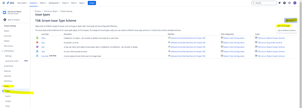

Go to project settting - Types - Action - edit issue types
Drag and drop the issue type that you need in this project then save

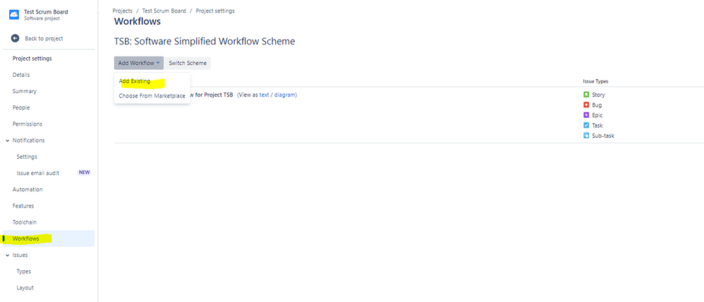

Go to project settings - workflows - Add workflow - Add existing - then select the workflow and associate to your issue type then publish
