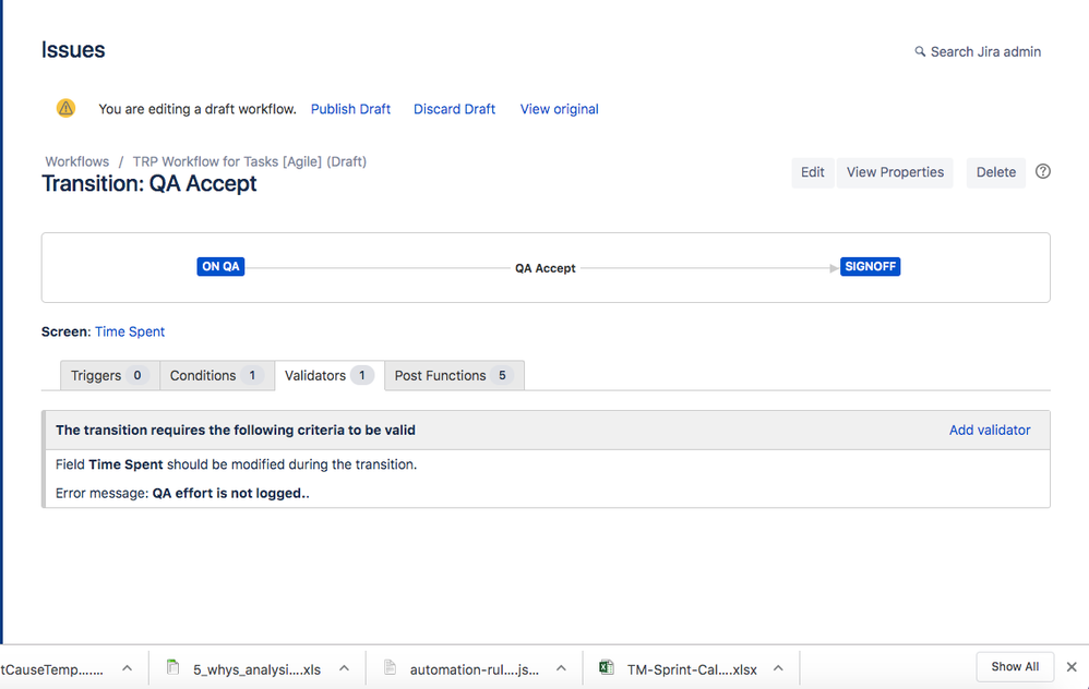

I understand that you are having a problem with a validator in your workflow. However I'm unclear of the details here. What field is using the QA and Sign Off values? Could you post us a screenshot of your validator settings? I might help us to better understand your specific environment and this situation to be able to offer more help here.
Andy
Hey Andrew,
Thanks for the update!

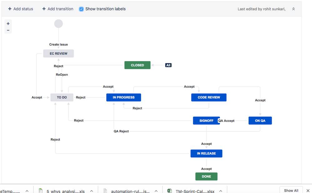

I'm attaching two screenshots. One for the workflow and other for the validator. I've added the validator when the issue is being moved from QA to  Sign Off.
